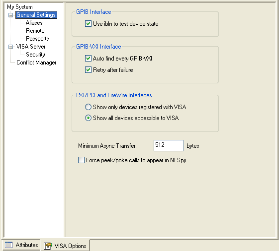

That’s interesting; I’m seeing the same behavior here. I found that if I change the “GPIB Interface ID” to GPIB0 the VXI system shows as expected. This was reported to R&D (# 207686) for further investigation. Also, I believe these were the options you were mentioning:
Found in Tools>>NI VISA>> VISA Options. Let me know how it goes and if you can see the VXI frame like you expect.
Matt
