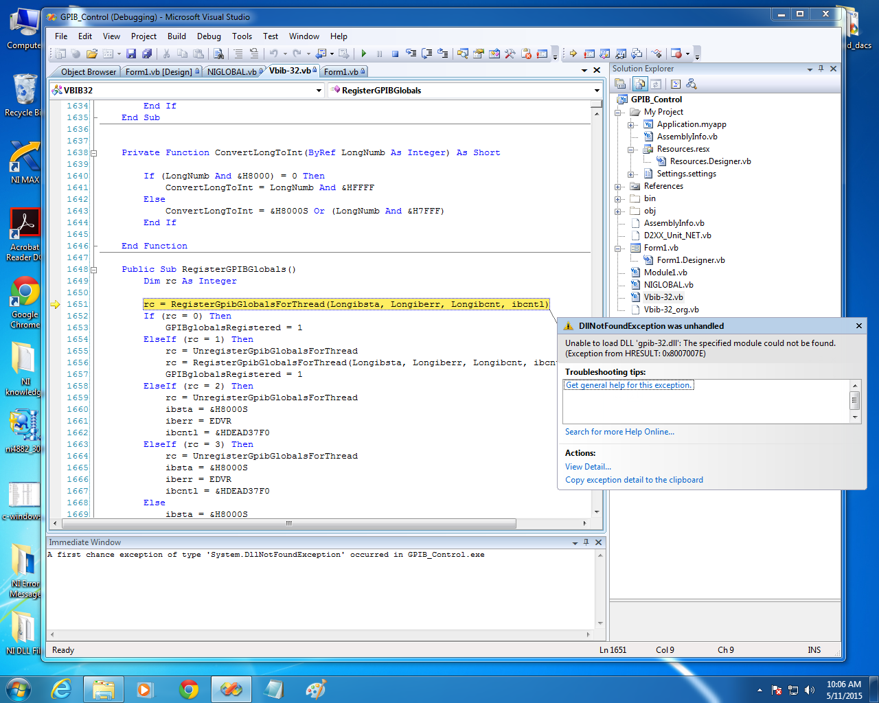

I tried to run my old program that ran successfully in my old window 7 32 bit PC.
My program has Vbib-32.vb and NIGLOBAL.vb and looking for "gpib-32.dll" because Vbib-32.vb has the statement such as
"Declare function ibwrt32 Lib "gpib-32.dll" Alias "ibwrt"(....) as integer.
But "gpib-32.dll" is not installed into c:\windows\system32 when I install NI 488.2 driver.
Right now I use window 7 64 bit PC, NI-488.2 ver 14.0 and I do not have LABView.
I just use PCI-GPIB board and use that board with VS2008.
I attached screenshot.

I also found gpib-32.dll in c:\window\syswow64.(I did not notice that before).
So I changed the statement  "Declare function ibwrt32 Lib "gpib-32.dll" Alias "ibwrt"(....) as integer into
 "Declare function ibwrt32 Lib "c:\windows\syswow64\gpib-32.dll" Alias "ibwrt"(..) as integer.
But the error comes as "An attempt was made to load a program with incorrect format".
How can I use gpib-32.dll in the syswow64 folder in my program?
Thank you
Seong

Finally, I solved my problem to use "gpib-32.dll" located in c:\windows\syswow64 directory.
I just compiled the program in 32 bit mode by
my vb program>properties>compile>advanced compile option>target cpu>x86.
Now I can use old vbib-32.vb and NIGLOBAL.vb module.
