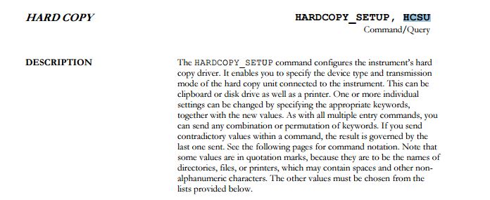

Hello jovertoom,
Let's try the command as:  HCSU instead of HSCU and see if that works.
Leonard Brown
Applications Engineer
Teledyne LeCroy
1-800-553-2769
Message 14 of 18
(2,824 Views)
Thanks for spotting that typo! However I am still having problems saving the image to file. I wonder if the problem is related to the format of the the data sent. Does the Lecroy scope send data in IEEE 488.2 over Ethernet? Does it use Definite Length Arbitrary Block” or “Indefinite Length Arbitrary Block", or does it just send raw binary data?
https://docs.google.com/document/preview?hgd=1&id=11AsY2WixTCI0_1at-wT3YP9JeLwjFl7uFuNGxlHI6ec&pli=1
Thanks in advance.
Message 15 of 18
(2,774 Views)
Hello jovertoom,
Sorry, I should have put the link in my previous post.
This is all in the remote control manual for the scope:  Remote Control Manual
The command is covered on page 220.
The response is IEEE 488.2.  If you have not turned off  the header response, you will need to remove this from the response before you write the file.
Send:  CHDR OFF first.
Then you can write the entire response to an image file and use it.
The response to the SCDP command will be the binary data for the image file.  You need to write this data to a file with the correct extension.  i.e. .bmp, .jpg...
