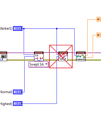

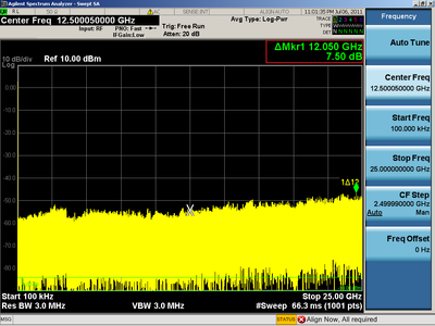

I got a N9020A model (firmware ver. A.03.08) in my site. I run the "Agilent MXA Series Configure and Query Marker.vi" with the following settings (see fig 1) and seems everything went on well. The marker amplitude indicates the delta value in the instrument (see fig 2).
Noticed that you have setting the marker position by hand. To keep your manual setting when running this example, please remove the VI "Configure Marker Peak Search.vi " (see fig 3) .

Fig 1
Fig 2
Fig 3
