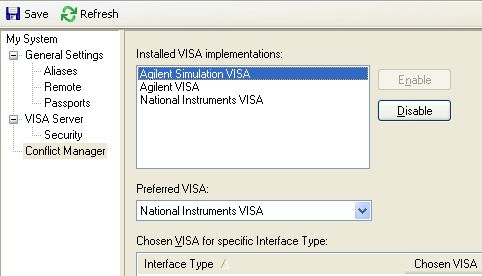

Lets look into why the 488.2 functions aren't working.  Did you keep NI VISA ar the primary VISA when Agilent IO Library was installed?
Open MAX>>Tools>>VISA Options and find out

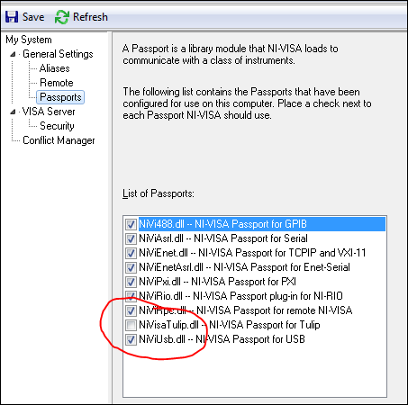

Next did you enable the tulip passport?
Capture1.PNG:

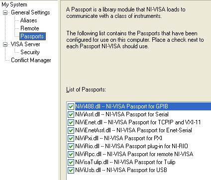

At first my old settings were like this:
So I change all Agilent to disable.

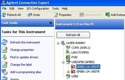

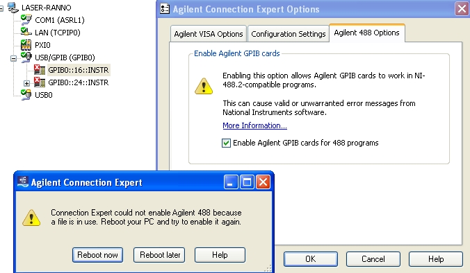

I was looking for some answer to agilent problem and I found I need to allow in "Agilent connection expert" other 488 programs to use card. So I try but everytime (with or without restart) I get thisAgilent.jpg

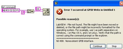

However, I try simple command like this with result:
And function from VISA palette are still working.

Clicking the "Allow other 488..." from Agilient CE overwrites the prefered VISA from MAX.
Basically ACE and MAX are alternate hardware configuration tool sets.  use one or the other.  ACE doesn't play well with LabVIEW and NI VISA.  so just use MAX.
