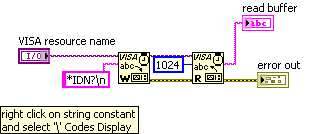

It sounds like you may need to send the instrument in for repair. The Instrument I/O Assistant works the same way as the VISA Interactive Control. You get an error there so I don't quite understand why the interactive control works. Just so I understand everything you are doing in the interactive control, you go to the Write tab and have the string '*IDN?\n' and then click the execute button. You then go to the Read tab, click the execute button and in the buffer window, see a string? You have to be able to do an execute in both tabs without an error. If that's the case, then the LabVIEW code below will do the exact same thing as the VISA Interactive Control. If the code below works, then try removing the \n character. A GPIB instrument is not supposed to need this and I'm curious whether you would get the error.

That's a completely different error code. That's timeout error. The results from the interactive control query are strange. Most GPIB instruments do not return a CR/LF. I'm wondering if the instrument requires a different termination character at the end of the command string. First, make sure that the string constant where you have the *IDN? is set for '\' Codes Display (right click on the constant). If it is, try putting a \r\n at the end of *IDN?

I just had a look at the instrument manual. I assumed that since this was a fairly new instrument, that it would use 488.2 termination. The 488.2 standard calls for terminating a command with just the GPIB EOI signal. It looks like it requires the CR/LF. That would explain a lot of the problems. The suggestion I made in the previous post should make the program work.

\r\n worked , thank you. Now I'll see if I can get a measurement reading into a VI.
