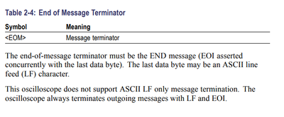

According to the manual for a hardware I'm trying to automate using pyVISA, termination has to have LF and EOI (end or identify). However, how do I ensure EOI happens, and what exactly is EOI?
From the manual:
What I have so far:

Thank you, that helps for the understanding a lot! However, how would I set that as the end of the read/write termination? I'm a function called read_raw() and it terminates when it sees \n. Since I want to only terminate at \n and EOI, how would I indicate EOI in a string, to be implemented in the code snippet from above?
(3,088 Views)
You don't have to do anything extra to send EOI.  Its managed by the bus, serial or GPIB protocol, as long as you have the EOI = TRUE which is the default.  So in your case changing the write_termination should be all you need to do.
You might also consider setting the instrument/bus timeout to something long (3 or 10s) if you aren't getting all data.
