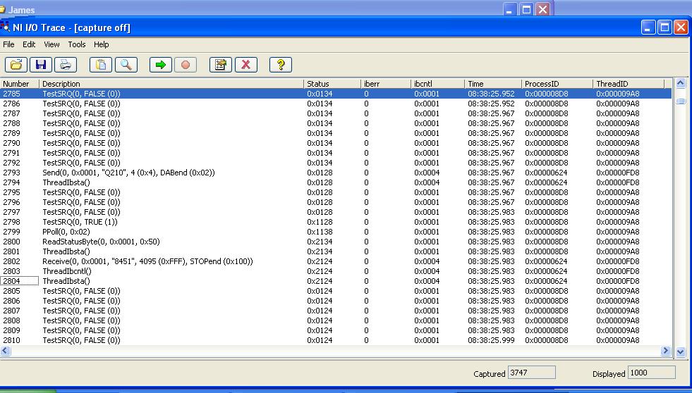

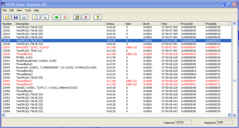

Even after tryiing that I'm still getting seemingly random timeout (EABO) issues.  I would assume that I might have a hardware problem if there wasn't a LabVIEW program that essentially does the same thing that works perfectly fine.  I've posted a portion of the NI I/O Trace (Though I admit I'm not quite sure what everything means):
Any further ideas?

What is the most recent piece of code that created this NI I/O Trace and how did it differ from the previous iteration? Do you observe any change when implementing the timing suggestions that were suggested above?

The second chunk of code posted is the one that created the NI I/O Trace shown above.  To be honest, everything I have tried has ended in the same result (random EABO error/timeout errors).  There is an integrated part of Instron software that can query the controller (and has 0 problem doing so)--I happened to also do a trace to potentially isolate any differences:
To me the only difference between the two is using Send vs. ibwrt on the write command but I am not a pro by any means.
