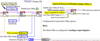

Thank you for your reply. For your suggestions:
1) How do I set my GPIB card to the slowest speed? Is it done by changing the setting as shown in the screenshot below?

Hi
The speed of the bus can be changed in MAX the measurement explorer from NI. Select the gpib interface and check the properties for busspeed. I don't have an interface available so try first.
