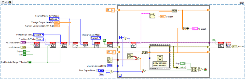

Simplest way is to setup the measurement, then loop over the "read single.vi" and plot that versus time.  Here's an example.
Alternately if you need faster measurements you have to look into the trigger model and use a timer to trigger the measurements.

Thank you for the replay, but this program doesn’t activate the Ammeter mode and neither the 1A range e 20V range

This program sets up the 2450 to source voltage and measure current.  You can specify the range for both on the front panel.  What does it do when you run it?  (I don't have a 2450 to test it on.)  Does it generate errors?
Use highlight execution (lightbulb) to watch the block diagram and see if there's an error somewhere that needs to be resolved.

It set the instrument in Voltmeter mode, but to do the misure that i need, it must be set to Ammeter

The 2450 is an SMU, source-measure unit.  So if you want it to behave like an Ammeter then you set it to Source voltage and measure current (Ammeter in parallel with a DC source) .  Now if you source 0V its just an Ammeter, and it will just measure current.  That's what the code does, but you decide what voltage you want.  You also decide on the current limit.

The example cstorey gives in the start of this thread is the way to go.
It is a snippet that you can drop in your blockdiagram. Download the png and drop it.
Depending on the LabVIEW version and if you downloaded the driver for the 2400 series it should work.
