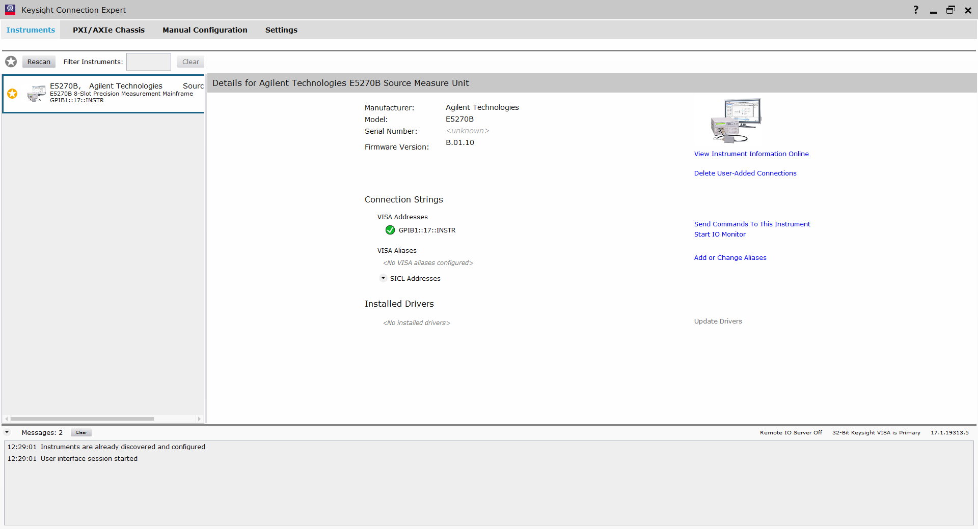

I installed keysight IO library suites and it can detect my instrument as shown as attached picture:
But it didnt shows up in MAX after i installed NI-VISA. However, i was able to detect the instrument in labview "find instrument driver" .
I have also enabled keysight 488 option in keysight suites and NIvisatulip.dll.

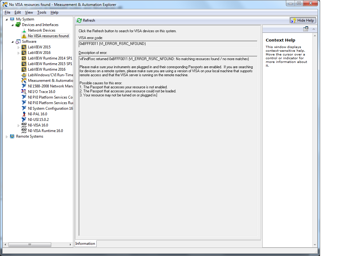

I also attach the max error below :
Message 2 of 8
(7,529 Views)
Hi William,
the device has to be detected by MAX so you can work with it in LabVIEW.
How is the device connected to your PC? Is it a network device? If so, do you now the IP Adress of it so you can search it manually?

Hi anna,
Thank you for replying,
The device is connected with GPIB  HP GPIB PCI-E card as shown in device manager picture. Can I search for it manually too ?
I can see the instrument when i tried to find its driver in in Labview as shown in 2nd picture.

Hi anna,
I managed to see the devices after uninstalling all and set Keysight Visa as secondary visa. It seems that i didn't set it in previous installation. Thank you for the guidance.
