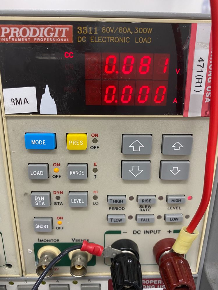

Dear all,
I test the Prodigit DC Electronic Load 3311. It draws current but showed 0 on the screen.
What is going to the unit?

How did you determine that the ELoad is drawing current?
Just from looking at the image, there is a button called SHORT which is 'ON', I would assume that it just shorts the inputs and without any control on load.
