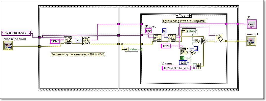

I use an Agilent 8563EC and I use "ID?" with a VISA Write node.  I use "*IDN?"  for IEEE 488.2 compliant equipment. Note that pre-IEEE 488.2 equipment do not use the "*<query>?" form? It can be anything the manufacturer decided for their equipment. In this case, HP used "ID?" with no star/asterisk.
