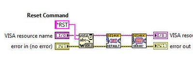

Original Reset.vi

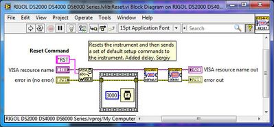

My Reset.vi
3. Charles.Tac described workaround for Initialize.vi.
DS6 works.
DS2, DS4 work if you delete or disable "the viClear function in the Initialize.vi".

I was hoping you'd answer Dennis' question, as I am also having trouble determining exactly what your question is. I can offer some input though.
I am not directly familiar with the instruments in question, but as you have discovered in your reset function, sending multiple commands without any delay in between can sometimes cause issues depending upon your instrument and the settings of your interface device.
