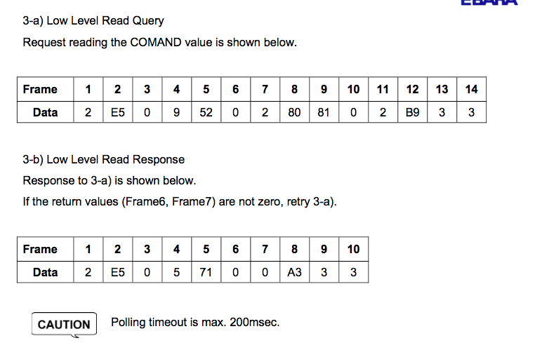

I am trying to communication with some lab equipement (Ebara Turbopump) over rs485. Now I have a Blastronix 2 port RS485 PCI board connect with cabiling to the equipement. But when I try and use NI-VISA to communication, the read times out, which is not particularly useful information because I don't know what part of my query is wrong then.

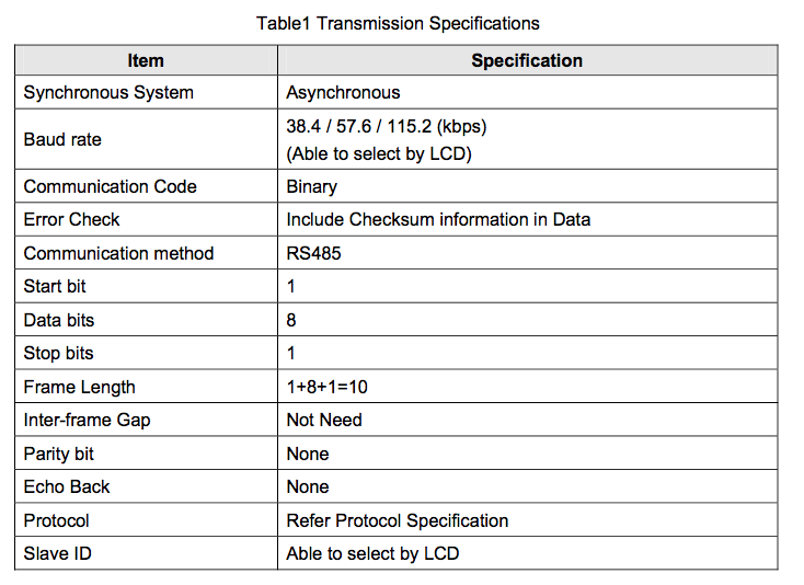

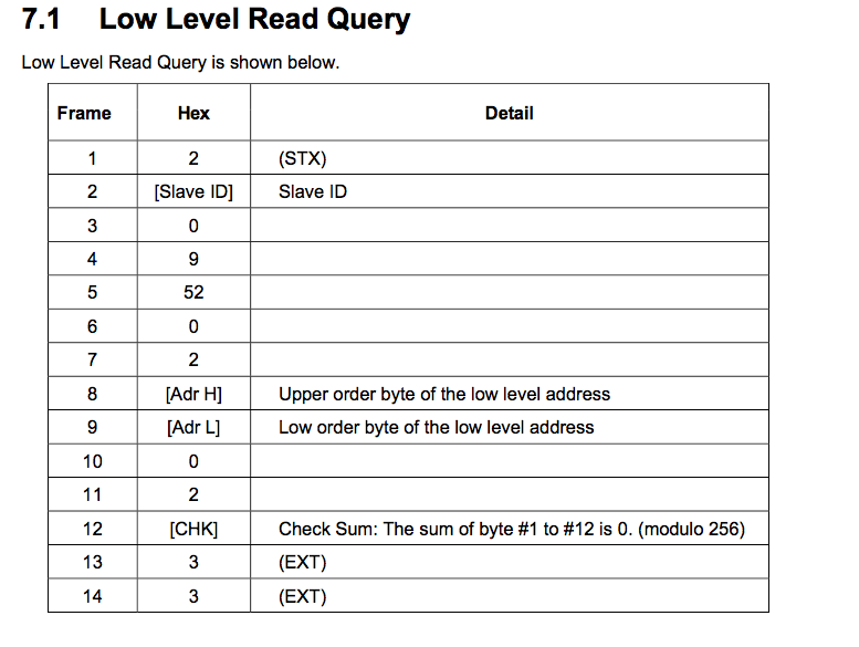

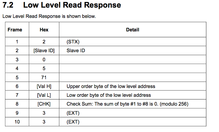

Below, I've posted some images from their communication protocol, but I am very confused as to how to translate this into a Labview VI. So far I've tried using a String Constant with the example 8.1 (last image, with my slave ID: 001) but I get nothing. I've tried it in both ASCII and Hex with a carriage return at the end.
Any help is very appreciated!!
Screen Shot 2015-05-25 at 5.45.43 PM.pngScreen Shot 2015-05-25 at 5.46.06 PM.png
Screen Shot 2015-05-25 at 5.46.16 PM.pngScreen Shot 2015-05-25 at 5.55.24 PM.png

Did you right click on your string control and select hex display? You do not send a carriage return at the end. The command is terminated by the the two ETX characters. You could also create a U8 array (set for hex display) and use the Byte Array to String function. If either of those do not work, check your cable and verify it is correct.
