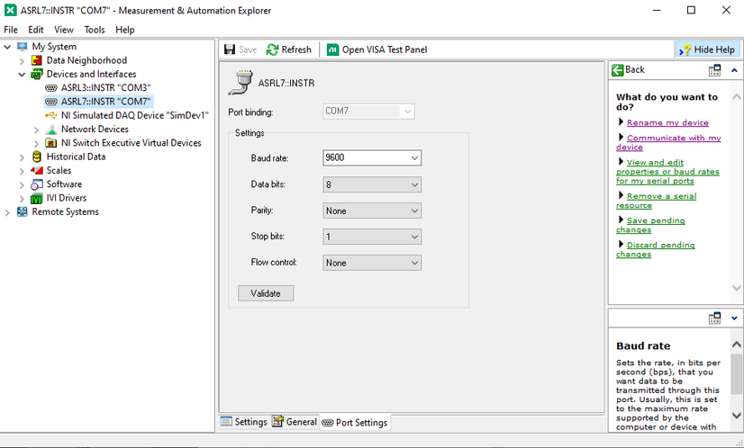

I am trying to connect a THS3034 Tektronix oscilloscope to LabVIEW....When I connect the scope to the PC through the USB port, the device is not detected.. I have installed the necessary  drivers for the scope...I have connected the scope to COM7...The Scope is detected as a USB device in the device manager in Windows.. But it is not detected as a USB device in NI MAX...Why is the USB port appearing as a Serial port in NI MAX ? Any suggnestions would be helpful. error_scope.PNG

Check the user manual. It supports USB Virtual Com port only.

@Anupama07 wrote:
is there some way to connect this scope to LabVIEW?
Use VISA to connect to COM7 and treat it like a serial port.  That is the point of the Virtual Serial Port driver.
