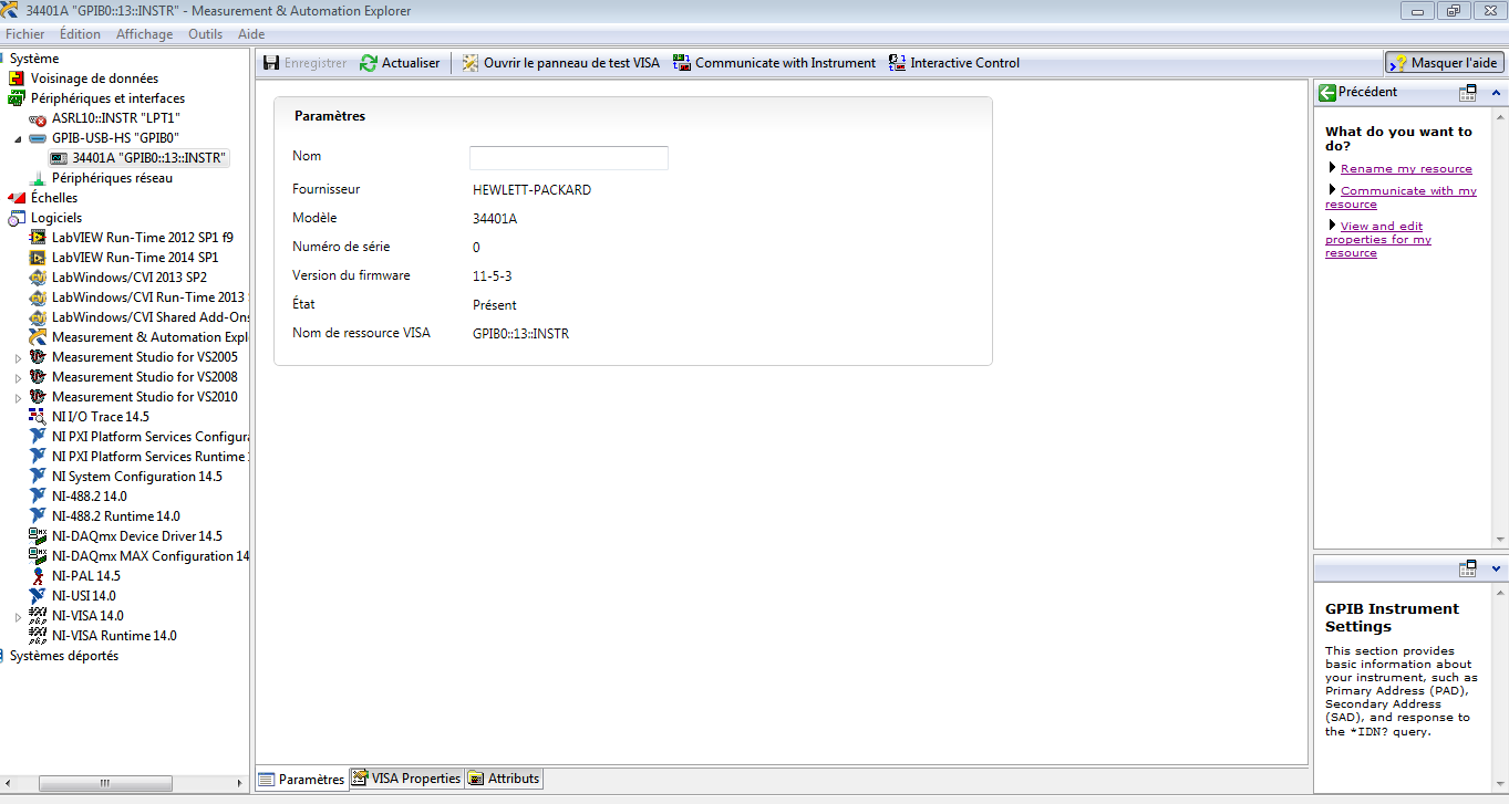

how can i create an interface between Agilent 34401A  with GPIB in labwindows/CVI that can communicate with my DMM and i can send commands that can read them pllllzzz help me
note i get the GPIB connected via NI MAX

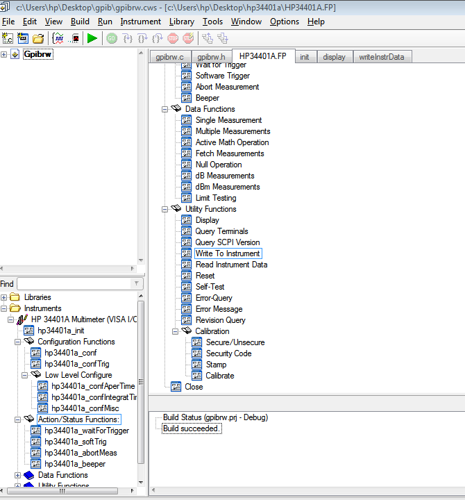

i already download it but i can't seem to know the step to creat an interface to communnicate with Agilent 34401A plz some one know the step that i need to do in order to create this interface so i can write and read DC voltage ......???????

That's really a basic CVI question, which I don't have at the moment. You should be able to load the fp if you installed the driver correctly.

the driver has been installed correctlly  and the fp file correspond to DMM  Agilent 34401A is been showen and i don't know the next stap wich will be what???fp.PNG
