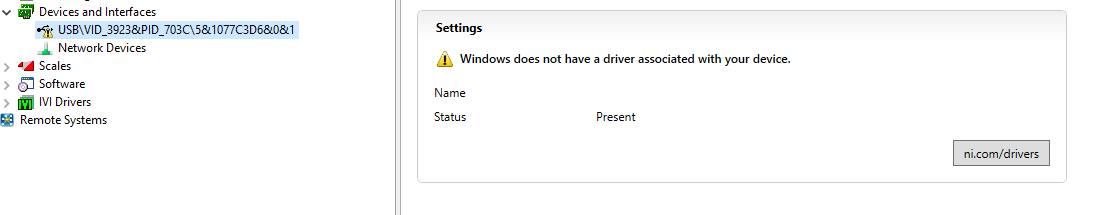

I have a USB-485 which I have use on a Windows 7 64-pc with no problem. But when trying to install it onto a Windows 10 pro pc then NI MAX indicates that windows has no driver for the device.
What could be the problem?
