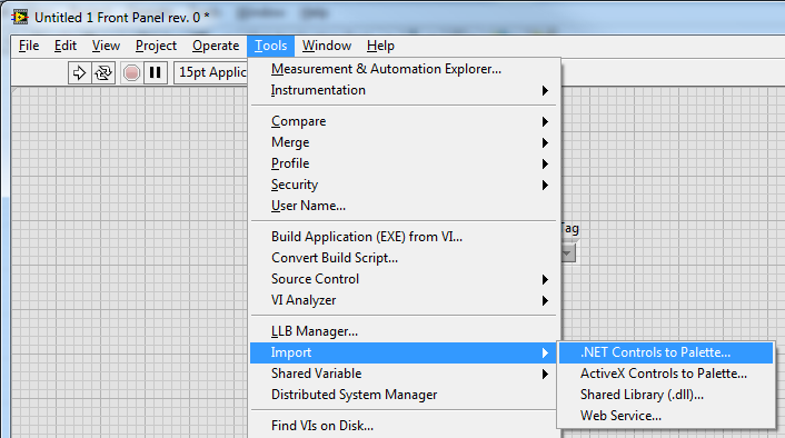

It looks like MCC is defining a part of the control functionality in a .NET assembly- I don't have the dll installed)
to get these controls to show up on the palatte you need to import them.
Tools: Import: .NET Controls to Palatte.. and browse to the dlI  I'd show pictures but this silly machine doesn't have flash ....yetSmiley Sad

Hi Jeff,
I tried your tip, and I am getting an error that says "you must have the .net framwork 2.0 or later to use .net function and applicatino.  Refer to the Microsoft Web site at ...."

Intsall >NET.  Then install NI-VISA (to provide support for .... yada yada)
Sounds like driver support was installed before ,NET so support for .NET would not be installed
