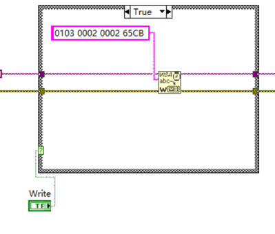

Hi Sir,
Sorry for late reply, I had a business trip to Vietnam for two weeks.
The background is that I purchase a temperature sensor, from the instruction of the sensor:
send :  01 03 00 02 00 02 65 CB
and also get back some hex value like that.
So that is the reason i asked this, how to deal with this when the sensor accept hex data and return hex data.
Thanks.

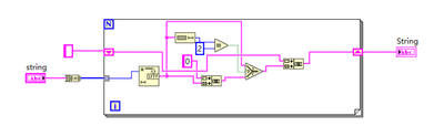

Hi
Hex is a translation of integer, or other number representations in hexadecimal.
Attached a vi in LabVIEW 2020  that translates the first part of your string into a 16 bit integer. (I16)
And also translates that back to the same string even with the leading zero by asking for 4 places.
This should help you in realising your own translation dependend on the integer type(s) used.

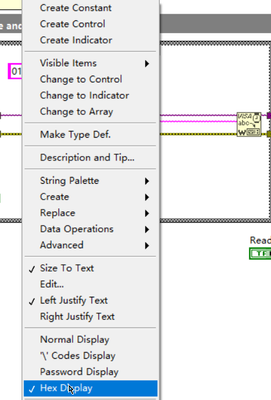

Thanks for your info,
What is the difference for hex display and normal display:
Also for the output, we need to convert like this ?
Learning from other people, sharing ! bruce.xw.zhou@foxmail.com
Message 5 of 10
(3,326 Views)
Normal display shows the string as ASCII characters.  Hex display will show the hexadecimal representation for every byte.  For instance, if you have the string "301" in normal display, it will show as "3330 31" is hex display.
Since you have not given us information on the content of the messages, we cannot say how to do the conversion.

Understand.
"301"  --> 33 30 31
But finally this will impact the content to VISA write or not ? or just different kind of display to us ?
Thanks.

Visa needs a string, so you need to convert the numbers into a string.

@Brzhou wrote:
Understand.
"301"  --> 33 30 31
Thanks.
Only the display to us is different.  The bytes in the string are the same.
