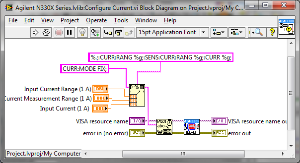

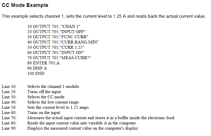

I have only modified the driver in a way that will allow my application to function properly (i.e. allowing user to select between modes of operations (CR,CV,CC) without error occuring).  The modification is only done on the Config Voltage, Current or Resistance subVI.
I have attached an example of the modification done below.
CC Mode Aglient Programming example
Config Current
As you can see, I basically remove those 'call functions' that does not concern me and only include those commands that are used.  Almost replicating what I would do with the actual 3300 front panel controls.
