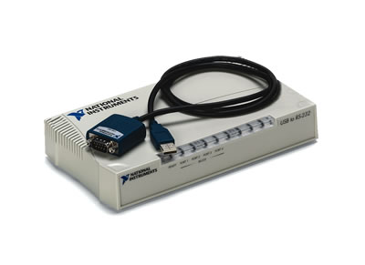

What advantage is there in using the NI USB-232/4 over an off-the-shelf USB to Serial hub?
What advantage is there in using the NI USB-232/4 over an offset USE to Serial hub?
NI USB-232/4
I have an application that requires LabVIEW control of 19 instruments that communicate over RS-232.
I've read the data sheet for the NI USB-232/4, and I don't see any advantage of spending $528 for this device (times five) over an off-the-shelf USB to Serial hub for half the price.
Can someone tell me if there's an advantage to the NI USB-232/4 or if they've had experince with one?

My main concerns would be the baud rate (I think the NI ones allow for non-standard buad rates), buffer size (very important for instruments that stream data), driver compatibility (which should not be much of an issue), and external power source (with that many channels, you will want this).  You will most likely be just fine with one of the cheaper adapters if they meet the external power standard.
