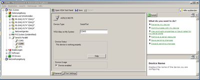

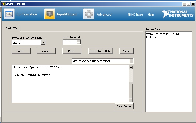

I have a Problem in writing and reading string from USB RS232 Adapter.
I habe a programm to write the string  to a Measurement device via USB RS232 adapter. but it shows a error,
(but In VISA, I find the vitual channel "com9" and click the "open VISA Test Panel". and then click "input/output"--"VELLO7\n"--and then enter the string, the Measurement device responses.)
Can somebody give me some advice?

you have so switch on the "Codes Display" in your String elements (Controls, Indicators and constants).
If you take a look at "CodeDisplay.jpg", you can see, that if you activate "Codes Display" you have the WRONG string:
You want to transfer "AMPL3\n" but you transfer "AMPL3\\n"
Also you find find a short example, how to add
- End of Line,
- Line Feed or
- Carrige return
to a normal string.
Remember, you can also check your string with the "Codes Display"
Hope that helps
