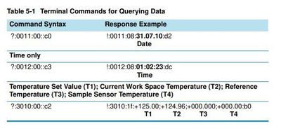

Hi Everyone,
Does anybody know the command to write to a Heratherm OGH100 oven . I want to write the Target temperature to the oven using a code. The manual does not give any information regarding this. I have still attached it for reference.
Can anybody help me out?

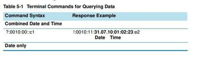

Have you tried these commands below:
You can find more information on this from this PDF starting from page 63.
