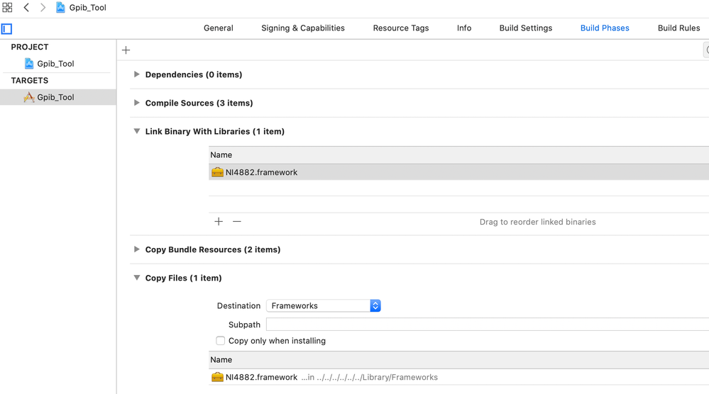

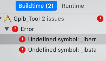

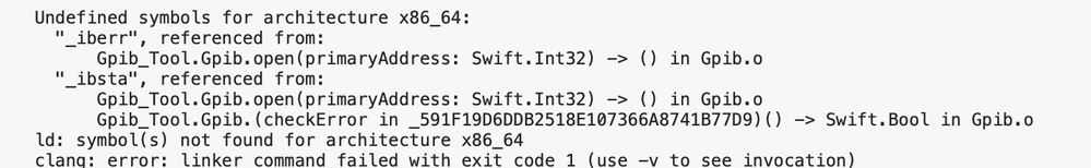

I use the NI4882.framework, and add Bridging_Header file (#import "NI4882/ni4882.h"),
but I get two issues: Undefined bymbol : _ibeer/_ibsta.
I've been able to communicate with my device (Chroma 62015L) using the NIvisaic tool.
Please help me and thanks for any answers.

I remove the Ibsta() & ERR variable, and compilation is done. (Any idea?)

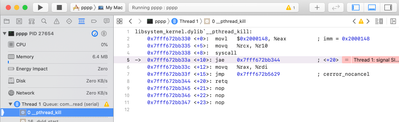

and NOW, I get a runtime error...see the picture below.
Please help me again, Thanks you.

I solved this question by removing the "TARGETS -> Signing & Capabilities -> App SandBox" in swift project.
