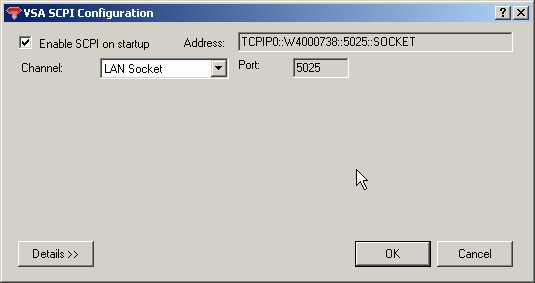

The VSA software shows about its interface:

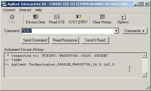

And using Agilents interactive IO utility to send an *IDN? to the VSA device looks fine
