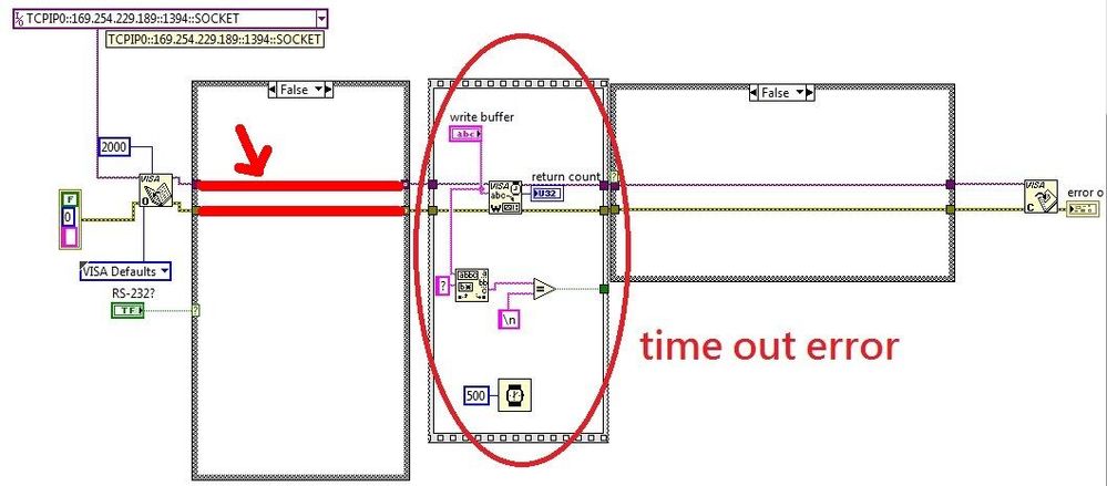

I want to control 6221 through ethernet method. The 6221 and 2182A are connected to each other with RS232 and trigger link.
I try to use the demo program Keithley providing to test the instrument. Both instruments are connected to computer successfully, and all functions work by using the demo program.
However, when I use my program, the error show up when the command is sent to "VISA write".
(No error at "VISA open") Further, the instrument do not show any "REM" word.

Dear all,
I can successfully control 6221 via ethernet when type command without question(?) mark.
When I type the command with question mark (like: *IDN?), the LabVIEW shows error. (something related to time out)
Furthermore, when I send command through RS-232 and trigger cable to 2182A, the 2182A do not have feedback. The front panel does not change to "REM" mode. ( I think this is the reason why LabVIEW show error related to time out, because LabVIEW cannot receive the feedback from 2182A.)

Your code doesn't seem to wire the VISA Refnum (and Error) in the case you are showing, so the commands aren't being sent to and insrtument and the VISA write just times out.  Connect the wires and you should be good.  See below.

Hi, thanks for your reply.
In fact, I also found that problem yesterday. After I connected it, the other problem show up.
As my second reply, I cannot query the instrument, and the 2182a doesn't be controlled remotely.
Smiley Frustrated

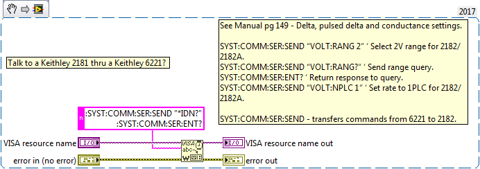

Ok, it looks like you have it setup properly.  I don't think you can get the 2182 to reply to *IDN? command in this setup.  *IDN? is a reserved 488.2 command, and in this seyup might not work.  But you can try this..
:SYST:COMM:SER:SEND "*IDN?"
:SYST:COMM:SER:ENT?
And see if that works.  Or try reading the Voltage range as the example in the manual shows.  You never know if they implemented all features or just what they needed.
Here's a VI to try..
Message 8 of 10
