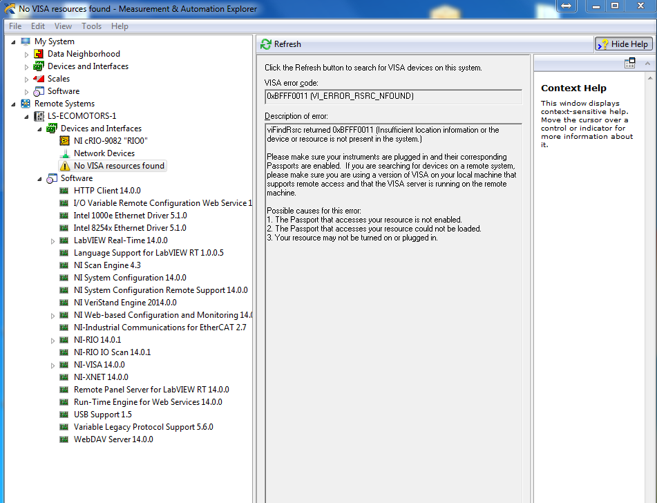

I have a cRIO chassis with 3 NI-9862, 1 NI-9205 and 4 NI-9401. But in MAX, there is a warning saying that 'No VISA resources found'. And the CAN, analog and digitla IO cards are missing.
Does anyone know how to resolve this issue?

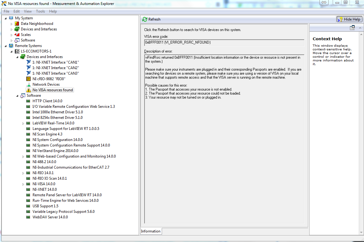

Right now, the good news is that the 3 CAN cards are available. But the analog and digital cards are still missing.

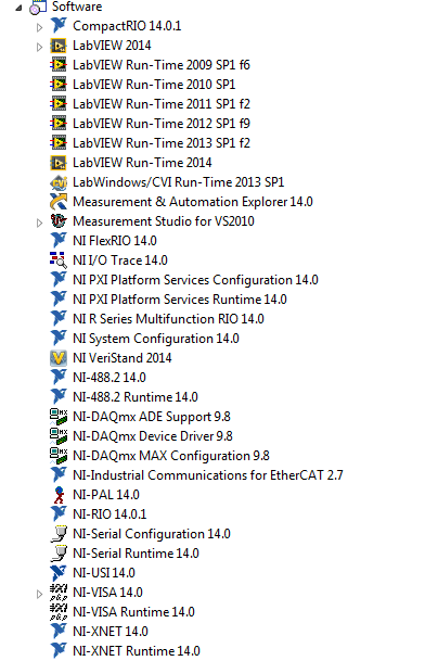

I do have NI DAQmx device driver 9.8 on my host. And for some reason, the CAN cards are missing now.
