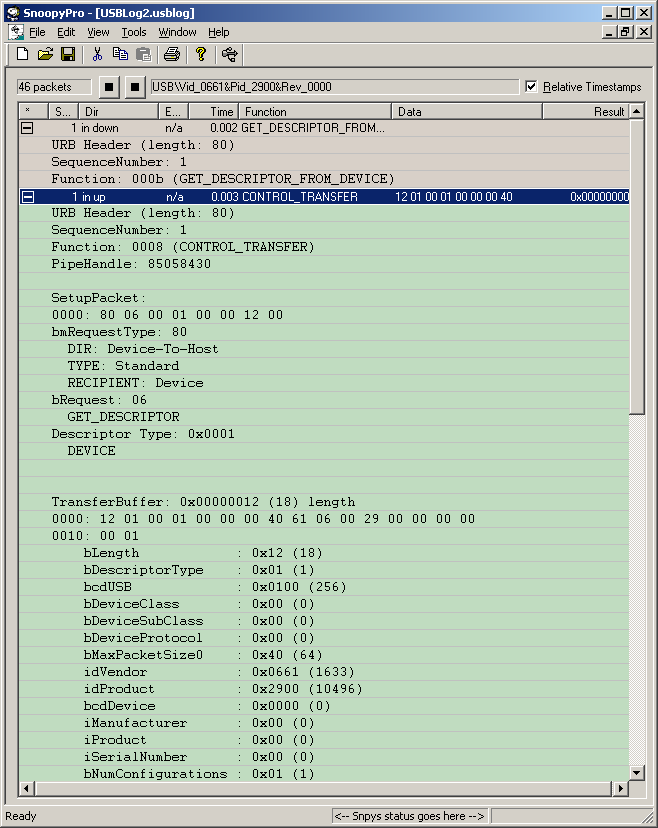

My problem is getting even the simple exchange in the picture to run in VISA.  I have never programmed USB before, so I may be a bit lost.....
Can someone tell me how to implement this simple exchange in VISA.  I know it requires using the "VISA USB Control out" and "VISA USB Control in" VIs, but I've no idea what to wire where.....

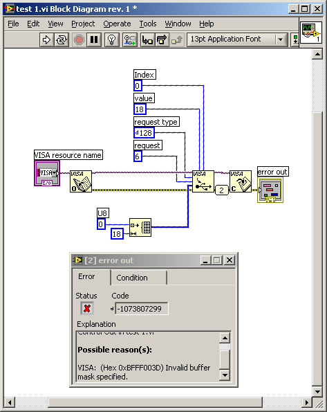

I'm getting a bit further in my quest (whether it's crazy or not). I've read a bit of the USB 2.0 spec, and have found out the following. In order to perform a GET_DESCRIPTOR_FROM_DEVICE command (Used during USB initialisation AFAIK) I need: bmRequestType = 10000000 (binary display) whereby bit 1 denotes data transfer direction "device-to-host", bit 2&3 represents Type "Standard" and bits 4 to 0 represent "Device". bRequest = 6 (GET_DESCRIPTOR) wValue = high byte = 1 "DEVICE", low Byte = 0 (Descriptor index) wIndex = 0 ? wlength = ? I don't see a wlength input.... Is this derived from the size of the "Write Buffer" wired? I've played a bit with various possibilities (wiring "Write buffer with varying lengths of U8 arrays from 0 to 72 bytes long....) I keep getting the error message shown in the picture (VISA:  (Hex 0xBFFF003D) Invalid buffer mask  specified.)..... What am I doing wrong? (The open VISA returns no error).
The USB sniffer program I have used does not give me the exact binary representation of the GET_DESCRIPTOR_FROM_DEVICE command, otherwise I could reverse-engineer the correct values quite easily...... Anyone help?

I'm getting a bit closer to the problem (which means I have new problems),
If I use the code posted previously, I see using my USB sniffer that a GET_DEVICE_DESCRIPTOR request is carried out (as intended), and responded to.  The byte sequence (as much as the USB sniffer shows anyway) is identical to "normal" operation.
I also see that the DEVICE_DESCRIPTOR is only 4 bytes long (the third query since a USB reset).  The returned values are also equal to those returned during "normal" operation, so I'm retrieving the right values.
Problem is, I still get the "Hex 0xBFFF003D) Invalid buffer mask  specified" error at the "VISA USB Control Out".  I can connect any length buffer to the Control out, or connect nothing at all, I still get the same error. Anyone have ANY idea what's going on here?
