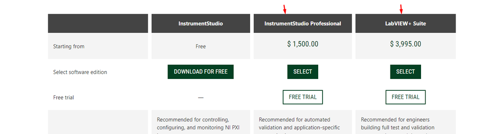

As you may know, DAQ is vast, evident from the large portfolio of  hardware and hundreds of APIs in the DAQmx drivers, so it is a himalayan effort to create a universal soft front panel in Instrument Studio. On the other hand, users of DAQ want a quick way to configure and collect data which the FlexLogger supports and recently they made the FlexLogger Lite version free, this way, users can work with DAQ without additional software license.
Please note that to use Measurement Plugin, you need Instrument Studio Pro license or LabVIEW+ suite
