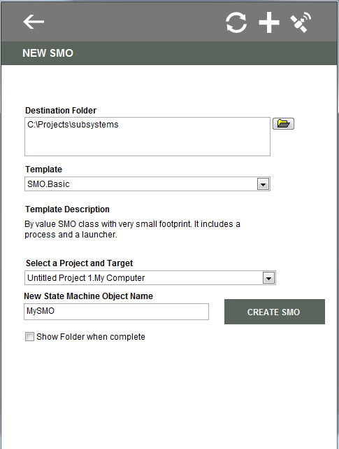

New version of the SMO Editor
We just published a new version of the SMO Editor. You should be able to find it on VIPM by searching for "SMO Editor".
This version includes a better user interface for creating new SMOs:
And an automatic way of creating Public/Private events and Public Methods for ByVal and ByRef SMOs.
Please let me know what you think.

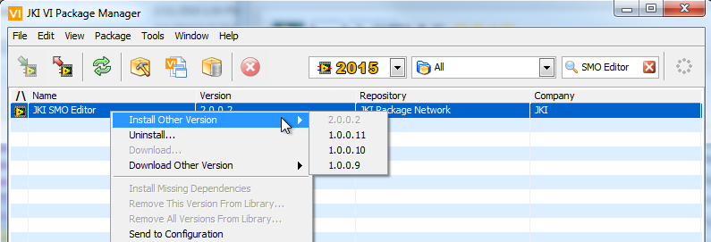

I have labview 2014 and trying to install new SMO Editor.
The search within VI package manager returns only version 1.0.0.11
Your link brings me to JKI SMO editor version 2.0.0.2 but when i click install it still installs 1.0.0.11.
Am i missing something?
Thank you
Vlad
(8,918 Views)
I just tried and it works OK for me. Try hitting the refresh button (round green arrows) on the toolbar and see if 2.0.0.2 shows up.
(8,918 Views)
That did it.
Thank you very much
Vlad
