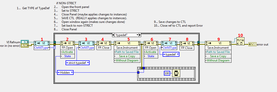

OK, this is weird.
As shown above, I have a "master" VI which calls the script subVI once for each CTL I want.
I saved things with the script SubVI set to SAME AS CALLER, and the master set to USER INTERFACE.
That should make the subVI run on the UI ExeSys, right?
Well, after starting from POWER DOWN, Running the master will work exactly ONCE, and then refuse to work any more.
If I change the MASTER from UI to STANDARD and back to UI again, then it will work thereafter.
If I save the scripting subVI with ExeSys set to UI, then it seems to work, even after a POWER DOWN.
(* crosses fingers* )

OK, the ONLY thing that will make it work first time, every time is a delay.
Attached is the SAVE part, which I have made into a subVI, so that I can use it on typedef clusters and tab controls, and whatever.
As shown, it works even immediately after a power up.
If I remove the delay, it will fail at some point.
