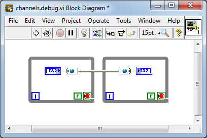

This does sound very odd. Just to be sure, are you right-clicking on the missing endpoint VI itself and not on the terminal somehow? I just tried things again with a clean install and I'm seeing the proper menus. If this is what you are doing then there might be something specific to your machine that we'll need to debug.
After selecting "Create Missing Endpoint".
I also just ran into a crash. If you hit undo a few times after doing this you might crash LabVIEW. I'll have to look into that a bit at some point ; )

I’m doing exactly what you show in your picture, right-clicking in the middle of the VI-with-Question-Mark, and seeing no “Create Missing Endpoint”. I just recently tried to again install the Popups after rebooting the machine (it’s a VM, if that matters, running Windows 7, 64-bit, with LabVIEW 2015 32-bit, downloaded from NI’s Web site as our Kit has not yet arrived). This time I ran the Install with Highlight Execution turned on, and it looked like it “did the right things” with no errors indicated.
