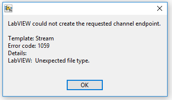

I'm good at breaking stuff and comming up with sequences that people dosn't think of . So here is the steps I did: I was trying to replace all the high speed streams with multiple read/writes. I chose to start with the reads. Right click on the stream read -> Replace -> Channel Endpoint... -> Select Stream -> Select Read Multiple -> click ok.I get this error:

The error is correct but unhelpful.
Read Multiple isn't supported if the element type is array.
Your original channel is HS Stream of type "array of waveform". If you try to replace the reader first, it tries to make a channel whose element type is "array of waveform", which means it doesn't have a "Read Multiple" node.
If you replace the writer first with "Write Multiple", that creates a channel of type "waveform", and that does have a Read Multiple, so replacing the reader next works fine.

I am going to adjust the error message to this. Does this text make sense?
Message 8 of 24
(13,481 Views)
That looks fine to me. Basically, we don't have arrays of arrays in LabVIEW. Read/Write Multiple use array of element so that won't work if element is an array-- there's just no way to create the type descriptor for such a beast.
