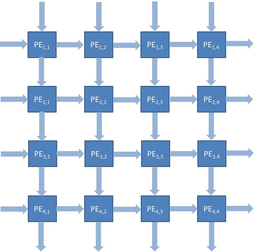

The vertical vs horizontal distinction does not sufficiently solve the problem for many of the applications I've written. The convention of data flowing from left to right is great, but more importantly data should flow in the direction that it needs to flow. Having built a number of applications that act like systolic arrays or mesh networks there is data that flows in every direction and I already find that LabVIEW doesn't make it easy to write code that looks clean for these situations.
http://www.ni.com/cms/images/devzone/tut/image3059823930869167811.jpg
I really want to find a solution that separates the channel communication layer from the dataflow layer in a way that doesn't require a flat 2D plane.
