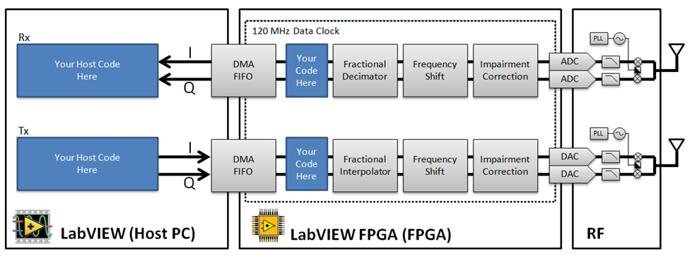

So, how does a USRP handle this? Well, there are several quirks that come into play with a SDR. Let's take a closer look at how a USRP RIO works:
In a very simple world, a USRP RIO would mix a signal to baseband, digitize using a ADC, and send the sample to the host. That's not how a USRP RIO works, however! There are several things to take into account. First, a USRP RIO, like most direct-conversion SDRs, takes both in-phase (I) and samples out of phase by 90 degrees, or quadrature (Q) samples. This is where the term "IQ" comes from. There are a whole pile of reasons this is done, many of which I don't understand. But the important thing is that this effectively means that the signal is being sampled twice as fast. That's why the term "IQ rate" is used, rather than "sampling rate". An IQ rate of 100 MS/s is roughly equivalent to a sample rate of 200 MS/s.
But what sets that IQ rate? The obvious answer is that this is set by the sample rate of the two ADCs--one for the I path, and one for the Q path. However, this is not true. The ADCs actually run at a fixed rate--roughly 120 MS/s for the 40 MHz USRPs, and 200 MS/s for the 120 and 160 MHz USRPs. When you set the IQ rate, you are actually setting the rate of the factional decimators in the FPGA. In other words, if you set the IQ rate to 12 MS/s, the fractional decimator will keep 1 out of every 10 samples. This has pretty much the same effect as simply lowering the sample rate of those ADCs.
So, in short, the IQ rate is neither the sample rate nor the Bandwidth, although it is closely related to both. It's the resulting sample rate of the I and Q components of the signal after some DSP has occurred. But roughly, you can calculate the bandwidth by looking at the IQ rate.

You mentioned doing this for transmit, rather than receive. In that case, the situation is the same, but reversed. Instead of downsampling, a fractional interpolator is used to up-sample the signal.
