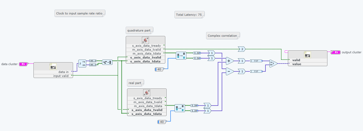

My problem is that when I open LTE Cross Correlation.gcdl I only see that the received signal is the input of two obscure FIR filters and at the end we get the value of the cross correlation. I do not see how the PSS sequence is used here, I do not see any calling to the PSS sequences lookup table. Therefore, I do not know how to cross correlate the signal with a different PSS sequence (assuming that it is only using the PSS sequence for (PCI mod 3) = 0, which I think is the most likely case since the UE does not synchronize when the eNB transmits the PSS sequence for (PCI mod 3) = 1 or (PCI mod 3) = 2)

Just as I supposed, the received samples on the receiver side are only cross correlated with the PSS sequence for (PCI mod 3) = 0, that is the reason why the synchronization does not work when the eNB transmits with a (PCI mod 3) other than 0. The PSS sequence for (PCI mod 3) = 0 is integrated as a fixed time domain signal within the FIR filters though (both the one handling I and the one handling Q of the complex valued received signal). To change this and implement a different PSS sequence, one must open the Xilinx Core Generator of the FIR blocks and change the sequence.
I have got from the LabVIEW Communication support guys an updated version of the function "LTE Cross Correlation.gcdl" that implements a selective control for the (PCI mod 3) value and seems to change the PSS sequence inside the FIR blocks. I post it here should anyone encounters the same problem. Although, I have not tried it myself yet.
