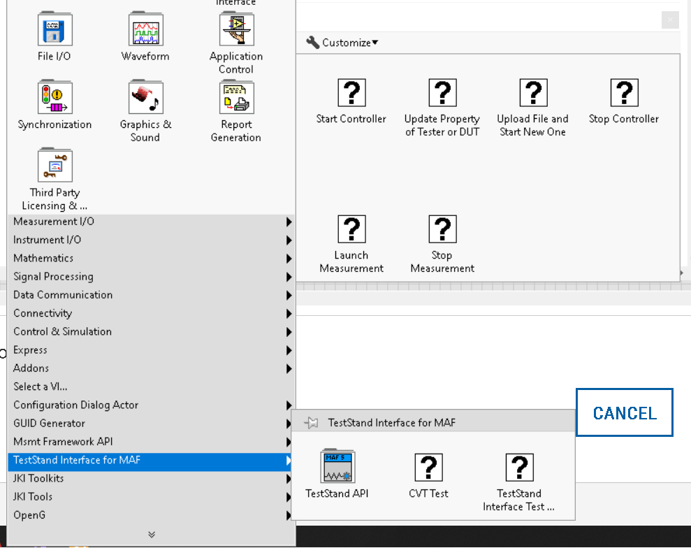

Good morning Elijah,
First of all, thank you very much example, which will be very useful to mewhich will helps me a lot with understanding the AF and OOP programming. I look forward to get deeper into it, but I have some issues while running the "Server Controller main.vi" which says"Application is broken and cannot be run" as David_Do in his msg from 26 févr. 2014 03:59, except that I am running LV2015.
I tried to desinstall the package and reinstall it as he did but it didn't work. So I take a look deeper into the main.vi and saw that the "Launch actor.vi" called into "Server Controller main.vi">>"Attempt to Start Controller.vi">>"Load App.vi" is crossed because it's no longer supported by LV2015. LV help told me to replace it by "Launch the root acotr" or 'Launch a nested actor" but neither of them belong an entry for the "Read enqueur.vi" exit.
Thank you very much in advance for you help, and I wish you the best for the new year coming.
Elijah_K
Active Participant
Active Participant
on
Gautier,    Are you sure you have the OpenG libraries installed? You can ignore the big X over the 'launch actor.vi,' as it's deprecated, but still works.
Elijah Kerry
NI Director, Software Community
GautierB
Member
Member
on
Thank you for your answer Elijah,
All the libraries are installed and VIPM says "nothing to do. All the packages are already installed." when I tried to install them again.
Could this error caused by the use of the base version of LV instead of the pro version ? Because I see that a lot of libraries which seems to come frome the pro version.

I downloaded the .vipc file (zip) and tried to run it. My VI package manager opens but do not indicate anything to be installed, neither can I find the utility in VIPM (I typed different names in search bar, including Measurement Utility). I wonder if I do something wrong? I checked for updates, too.
Would be grateful for some tips,
Anna
rwunderl
Member
Member
on
Anna,
I had the same issues. This seems like a poor way to distribute code to the community (forcing people to install lots of unpublished packages). But on the other hand, I understand it's a complicated project with lots of dependencies. That said, I unzipped the .vipc file (it's just a zip file, by the way) and tried to install one of the included packages. That's when I got an error in VIPM that the package had been built with a newer version of VIPM. Apparently this error does not surface when trying to open the .vipc file itself. I only had VIPM 2014 installed even though I had installed LabVIEW 2017 later on (and failed to check VIPM for installation). So I updated to VIPM 2017 and the .vipc file opened and installed as you would expect.
Now with the .vipc file installed, I am still missing packages and am working to fix that now. I'm missing stuff that's supposed to be in the "<vi.lib>\Skyline" folder but isn't. I do not have NXG or SystemLink Client installed, so maybe this is the reason? Why is Skyline a dependency?
Also it's strange that the Measurement Actor stuff got installed to "<user.lib>\Build Output\Measurement Actor" instead of "<user.lib>\Measurement Abstraction Framework\Measurement Actor" or some such. Most of the menu items for "TestStand Interface for MAF" are broken too. Any suggestions on this? I feel like it shouldn't be this hard...
Hope it helps,

Elijah, Thank you for great work! But I also got the same problem as Richard and WOLF_S.
Labview Version 17.0 f2(32-bit)
VIPM 2018.0.0 f2
Can problems arise because the Labview program is installed on 😧 disk (not system disk)?
