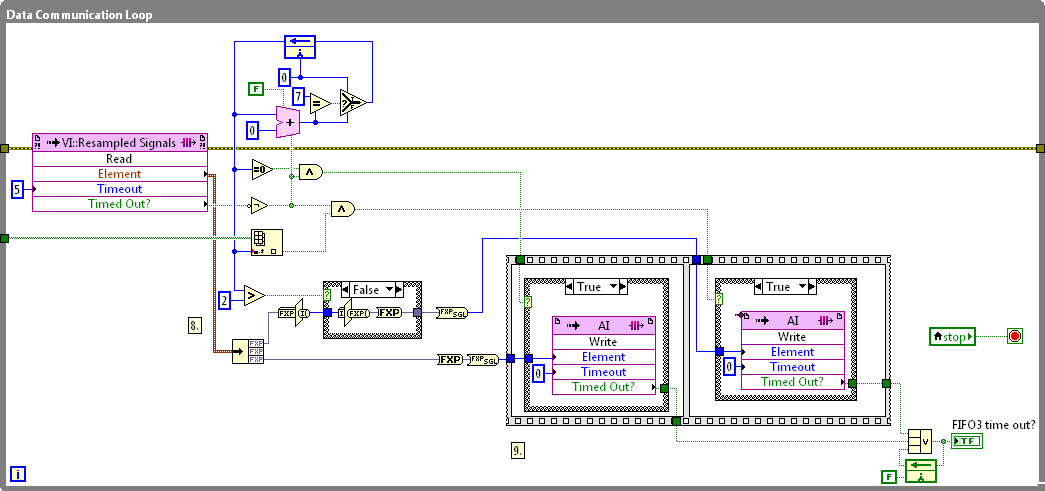

Hello! I'm using  cRIO-9074, NI 9225 <+/-,24,10> and NI 9239 <+/-.24.5> and EPS  to measure some signals. I'm normalizing the signals to <+/-,24,1> and pass to FPGA Resampling VI according to help and this white paper http://www.ni.com/white-paper/52519/en/ but I'm having a trouble with converts it back from the output of resampling.vi to appropriate values. I don't undestand what is going on in Data Communication Loop from the example (a piece of code with feedback node and why there's two write to DMA FIFO method):
and how shoud I adapt and simplify this code to my application with 6 channels (3 from NI9225 and 3 from NI 9239).

1. why there's two write to DMA FIFO method
The left FIFO stores frequencies and the right FIFO stores data.
2. a piece of code with feedback node
In this example, there are most 7 voltage or current signals (Mod1/AI0--AI2, Mod2/AI0--AI3) be acquired in the Data Acquisition Loop.
So every 7 data from the VI::Resampled Signalswere FIFO can be viewed as a group. And the frequency of each group is same. When a new group arrives, the frequency can be stored into the left AI FIFO.
3. how shoud I adapt and simplify this code to my application with 6 channels
Change the number of channels, reference channel index settings and wiring in front panel.
Change the Data Rate to match your modules in block diagram.
Thanks!
