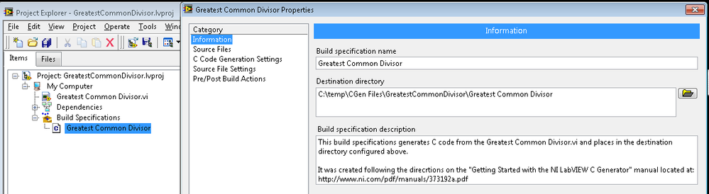

GratestCommonDivisor.lvproj C Generation build specs Information:

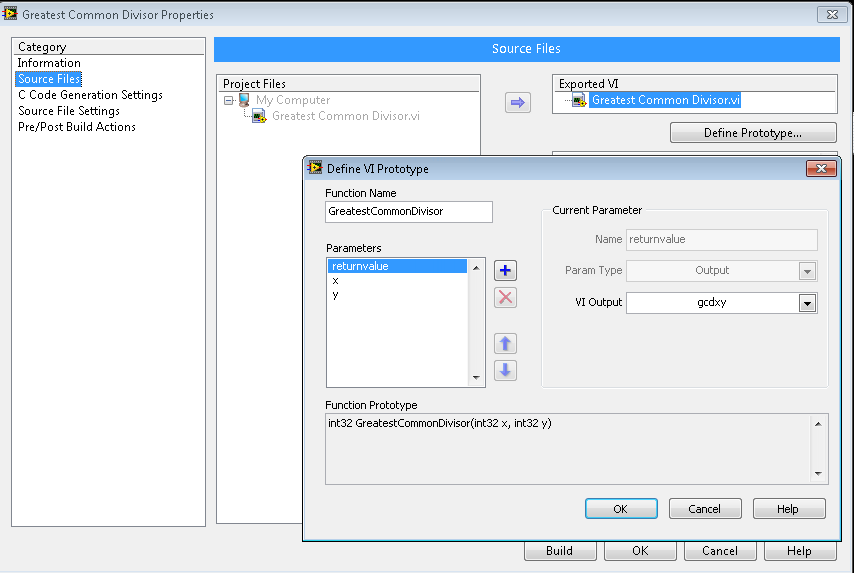

C Function prototype definition:

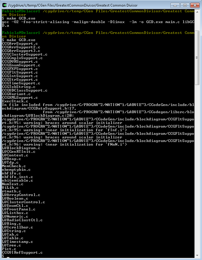

Here is the snapshot of the results after executing "make GCD.exe"
Then to run it I just type
I see a window open and close really quickly and I never see the result. I have tried adding the getchar() line to the main.c file, but still I don't get to see the results.
