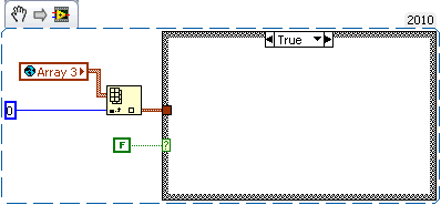

this LabVIEW code creates this error:
snippet.png  paste this snippet in a vi.

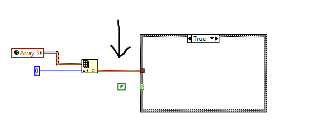

the global array (Array 3) is the following:
snippet2.png   paste this snippet in a vi.
this is an array of a cluster with an U32 and an U8

The problem is generated by an index array vi with an Global cluster array as array input.

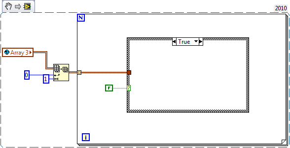

My workaround:
Instead of the index array function, I'm using Array Subset vi, with a length of one.
because the output is an array, I'm indexing is it by a For loop.
Because it's an array of one element, you can assume that the for loop does one run, and so you can disable auto indexing if you are using outputs from this for loop.
Hope this can help others, It works for me.
