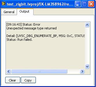

The program build correctly and when it's starting the target, it doesn't entering in debug mode, debugger says that there the run failed and I have this message :
Detail: [UVSC_DBG_ENUMERATE_BP,MSG: 0xC, STATUS: 0x1E](30)
Status : Run failed.

I try to enable and disable Embedded Variable Connection Manager to see if something happen but the result is the same, I always have the same message.
Third line says that :  Detail: [UVSC_DBG_ENUMERATE_BP, MSG: 0xC, STATUS: 0x1E] (30)
I post my project in attachement.
