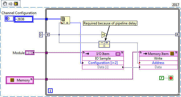

Jorn_Deruyck
Member
There's actually a method node for the NI-9205 that should be a bit more efficient for the use case you've shown in your diagram, see below snippet. (the index counter is 5 bit and set to overflow at the increment node)
The only drawback is that it still can't be run from within a SCTL loop 😞
NI-9205 Channel ReadNI-9205 Channel Read
