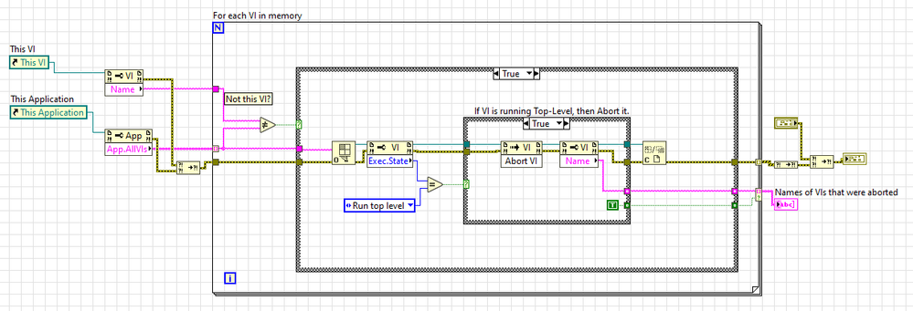

I've been using a VI named "Emergency Abort.vi" for this purpose. It aborts all running VIs, and is implemented as seen below.
The "False" case of both case structures contain no code, they just pass the wires through.
You may want to tick the "Run when opened" setting. This is useful when a modal window hangs. When this happens you can't double-click the VI in the project, but you can still double-click it in File Explorer.
The VI is based on the similarly-named VI shown in the LabVIEW for Everyone, Third Edition book.
Hope it helps.
Thanks for the suggestion!  However I've come across this tool before (and please correct me if I'm wrong), but I don't believe this finds and aborts reentrant clones (which is really what I need it for).
I also feel that this is functionality that would be better implemented directly in LabVIEW, rather than having users rely on external tools.

"However I've come across this tool before (and please correct me if I'm wrong), but I don't believe this finds and aborts reentrant clones (which is really what I need it for)." - I never tried using it for aborting reentrant clones, so unfortunately I can't say whether it works in that case.
"I also feel that this is functionality that would be better implemented directly in LabVIEW, rather than having users rely on external tools." - I agree.
Sadly, that doesn't stop all running VIs.
Top level running clones aren't returned by All VIs in Memory.
So, for each VI, you have to check if it's a reentrant VI, if so calculate it's 'magic' hash, in a for loop for an unknown number of iterations stop them (because there's no way to know how many clones are in memory).
