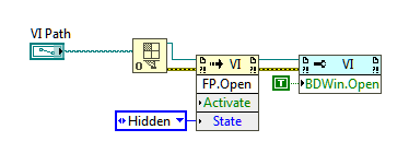

I find it a useful "workaround" to use the method FP.Open with state "Hidden" instead of FP.Close. This way the FP is gone, but the BD stays open.

BTW, this miserable piece of code has the often desired effect:
What is so difficult about it?
wiebe@CARYA
Knight of NI
Closing the diagram leaves the front panel hidden, and as a consequence, in memory.
That could have serious consequences! If the VI is a clone (even if it's not), and the parent leaves memory, the VI will stay in memory because the front panel is not closed (but hidden). A normal VI can still be removed from memory by re-opening the front panel and closing it (still a hassle), but a clone is hard to close once the FP is hidden.
jqu
Member
Member
Right. Thanks for the comment!
But we're talking about dev-time, not run-time. So in this situation I honestly wouldn't care too much about unreachable VIs hanging around in memory. But more importantly, I think the code I've shown above does never open any clone, but always the original, doesn't it?
However, I also see some implications having a VI in memory that is not visible any more...
But it's a handy hack anyways 😉
