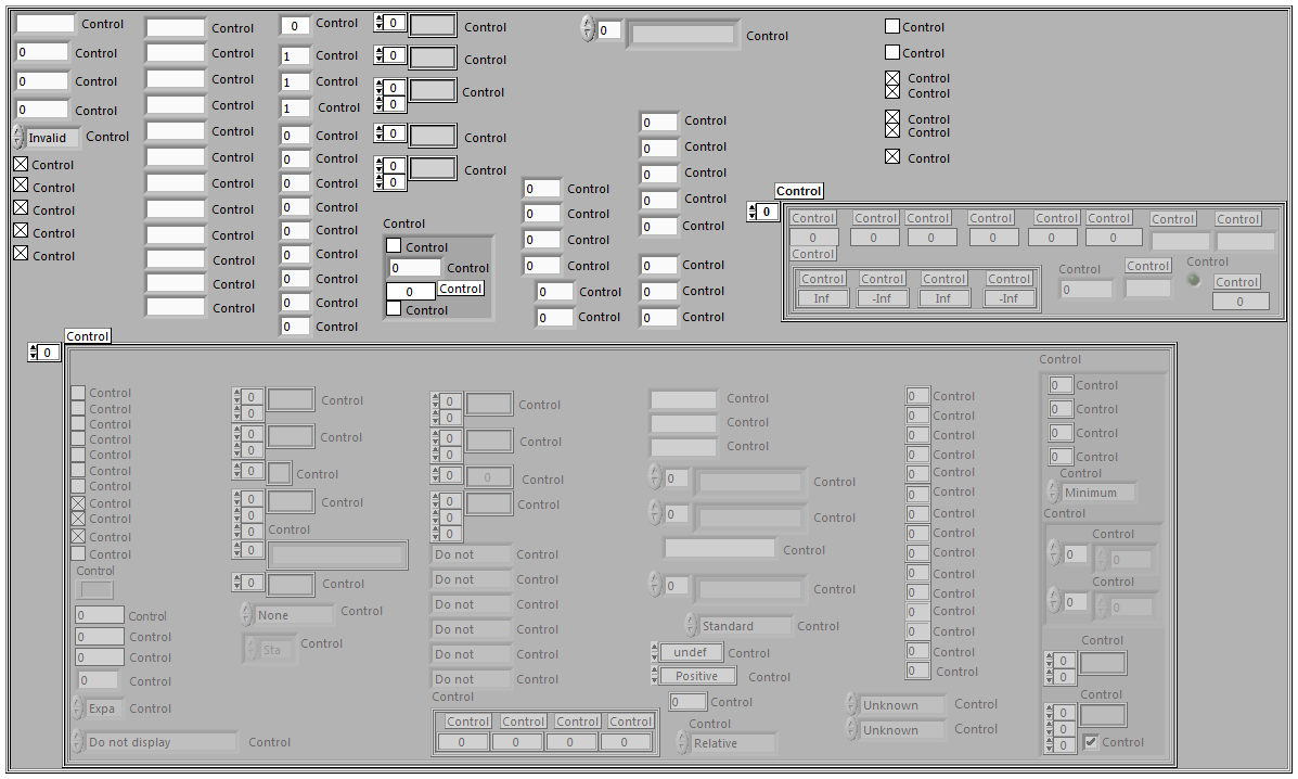

Just to better illustrate, here's a real world example (with the names obviously scrubbed. The majority of them were actually longer than here, so the cluster was bigger) -
undefined
This is the worst case I had to deal with. Roughly 200 controls in nested clusters. In my defense, I wasn't the one who created this code originally, but I did finish and expand it considerably and I can say that all of those controls were actually needed to keep the data that was required, and keeping them together was relatively important, because the data was later also serialized. I could probably have split them up, but that would have been artificial split without any proper justification.
As I'm sure you can tell from the style of the controls, this is pre-LVOOP, but even that would only help to a degree, because some of those classes would still have too many elements (as, indeed, do many of my classes today).
