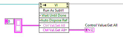

This is all I'm asking for:

We can dynamically start a Top Level VI. Or call a subVI with CBR but we need to know the strict type. Nothing in between.
I want to dynamically set inputs\get outputs and then run the VI (subVI or Top Level VI).

I just want to call a VI as a subVI (like new VI drop it, wire ctrls\indicators, run it), but by reference! A copy\template instance\close is totally useless.

A copy is not what I want. The user selects a menu item, and event is triggered. Now I want to automate that. So I need to send that event. In the development environment but also in an executable. So I need to make a VI that has only one sub VI, only because I can't call the subVI directly (dynamically).

I hope that the one thing you get from this is that *I do not want a copy*!
I want to dynamically run a sub VI (but not with CBR, and for non-re-entrant VI's)!

Your picture makes things clearer.
Yes, post that as a new idea... I think that will help.
