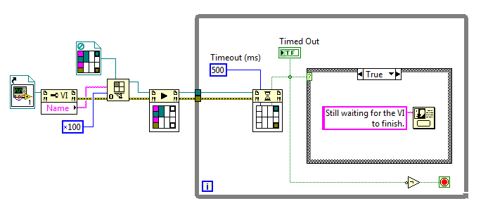

I want to have the ability to know when a VI is completed when it is called Asynchronously without having to wait for it to complete.  That idea was to allow to register for events.  I think the first step is simply to have a timeout control on the Wait On Asynchronous Call and an indicator that it did timeout.  If the function did timeout I would expect the data returned would be the default data for the data type that the VI would have returned.

This idea was evaluated and rejected during the feature design. If you want feedback from your subVI while it is running, pass a user event refnum into your VI when making the Start ACBR call and fire that event refnum inside the subVI. Or use a notifier or queue or any other signaling mechanism. Such communications mechanisms include a timeout capability.

WAHHHH!  Yet another idea I posted on the idea exchange that I don't get credit for it being a feature in LabVIEW.  Thanks for linking to that I didn't realize that was a feature and I may look into incorporating that into my application.  Of course as AQ said a better design is to use a reference telling the VI to stop, but if that VI locks up I want this timeout to be able to not lock up any other VI waiting for it to stop.

NI's implementation of that feature is not very discoverable/debuggable - the only way to check if a non-default timeout was set on Wait for Asynchronous Call is to right-click on it.

Yes the node doesn't have any visual identifier, it would be nice for some glyph next to the hour glass to indicate it has a timeout.  By the way I just tested and if it times out it does just return an error 123 Timeout Occurred which makes sense since there is no additional Timed out? output.
