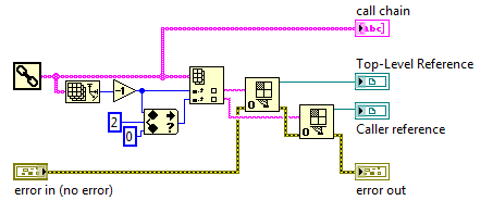

It would be far more useful if, instead of returning the string VI Name of each item on the call chain, it returned a VI Reference to each item on the call chain.
You can obtain the VI Name from the VI Reference; but not the reverse. The VI Reference indicates which instance of the SubVI on the block diagram of it's caller was the one in the call chain.
If a SubVI appears in multiple places on the block diagram, the call chain as currently implemented doesn't give you enough informatiion to figure out which instance actually was the caller...
