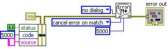

David_Grucza
Member
Doesn't the General Error Handler already do this, or am I missing something?
